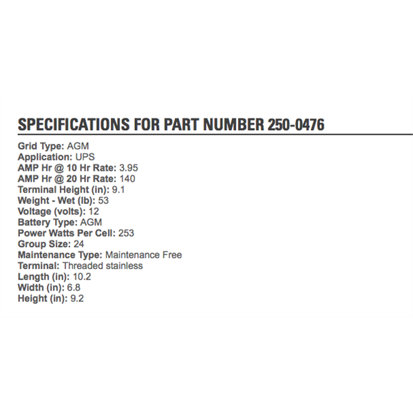

He sent me a spec’s sheet but could not work out how many amp hours these are rated. so
From the sizes s on the stock listed I would probably take the (250-0476) if the ratings are up around the 100 a/h mark.
From the specs below is it possible to determine the a/h rate for that battery please? I do this just to assist your brain storming – it is supposed to be healthy for us but beyond me.
Thanks again – regards Phil
The specifications for my selection are as follows as the sheet will not copy and paste from the email or from pdf file dammit...
Power Watts per cell for 15 minutes to 1.67 volts per cell @ 77 degrees F (25 deg C)= 253
The dimension is close to the old batteries = 259 long x 173 wide x 216 height & 24 kg.
Discharge Rating in Amperes for 15 minutes to end voltage of 1.75 VPC = 127Maintence Free, Non Accessible - Absorbed Glass Mat

Reply By: tonysmc - Wednesday, Jan 18, 2023 at 21:41
In their specs for the 250-0476 it says -
AMP Hr @ 10 Hr Rate: 3.95
AMP Hr @ 20 Hr Rate: 140
if that is any help?

Reply By: Member - Jim S1 - Wednesday, Jan 18, 2023 at 22:14
This any help ?
Jim
Cat Bat

Follow Up By: Peter_n_Margaret - Thursday, Jan 19, 2023 at 10:10
"10hr rate 3.95, 20hr rate 140" is clearly an error somewhere.

Reply By: Member - Phil 'n Jill (WA) - Wednesday, Jan 18, 2023 at 23:00
Thanks Tony & Jim, but I have trouble corellating the figures for 10 hrs and 20 hours 3.95 vs 140 ... bit hard to follow, unless you know the mysteries of 12 volt electgrickery I guess - cheers Phil

Follow Up By: Member - Jim S1 - Thursday, Jan 19, 2023 at 08:04
20hr rate is the standard .
Jim
