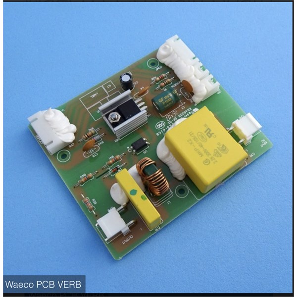

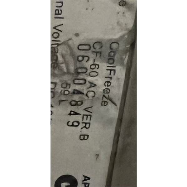

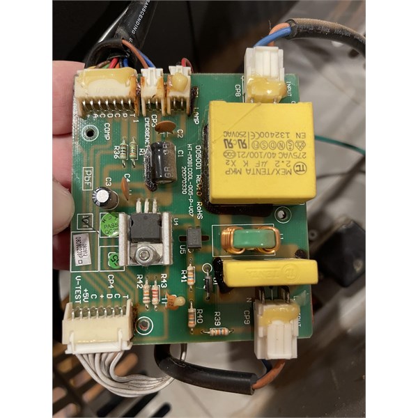

Hi Allan , yip the fridge is a CF60VER B type and the circuit board layout matches the picture on the web so I think this will hopefully sort this ..
CF60 VER B
My Ver B Circuit board
Web Site VerB pic

Follow Up By: Allan B (Sunshine Coast) - Monday, Jun 20, 2022 at 08:10
That looks right to me. Cross your fingers that the display board is OK.
