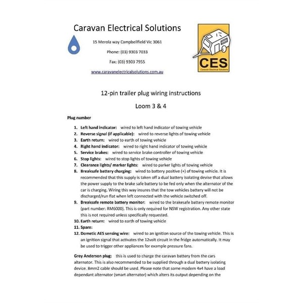

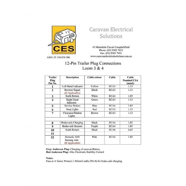

With regard to your comment on caravan manufacturers not providing a wiring diagram for the 12 volt connection to the car, the chart that I posted was the chart provided by them.
FollowupID: 917276

My comment wasn't specifically to the trailer plug wiring but to the whole van wiring. Car Manufacturers have far greater regulation and mostly there are workshop manuals available, some at outrageous cost with 3 thousand pages in 3-4 volumes, or the aftermarket ones. A caravan one should be simple enough, especially with production line manufacturing and being CAD designed.
I'm part way through changes to ours with a Lithium conversion and relocating a lot of the associated components and it's time for me to make up a set of documentation circuitry wise. What I can't do though is document where in the walls or roof they have routed the wiring, especially for the 240V stuff. That will remain a mystery, but shouldn't be.
When I wired up the car for the Anderson Plug and connection for the van ESC it was based on what little I was able to get from the Manufacturer and the Dealer. On picking up the van interstate it turned out that the info provided was wrong for the ESC but the Dealer provided no help from their onsite workshop and just said to go to an Auto Electrician and get them to fix it and come back. We took the van to the Caravan Park not too far away and I did it myself. Made use of some of the tools my wife wonders why I take them. A couple of other issues got taken care of as well, both poor workmanship.
FollowupID: 917283

I will have to check my paperwork Phil, but I am pretty sure I have a wiring diagram for the van as well. Of course, it may not be accurate, I have seen house wiring diagrams that are not accurate, so a caravan may also be the same.
