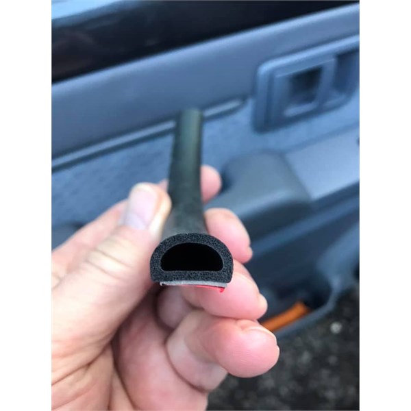

Read recently where a bloke used extra rubber seal on the inside of the current seal, in an attempt to reduce wind noise. Said it did make a difference.
A strip of this seal, right around the door, might assist in reducing vibrations, Kevin, as well as making the interior quieter too?
