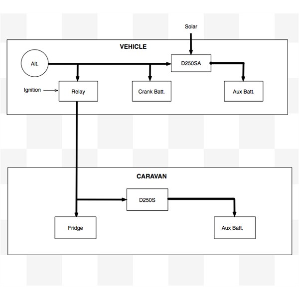

Hey Wayne, do you have a 3-way fridge in your caravan (12v,240v,gas)?
If so, I can suggest a neat way of connecting it to the 12v.

Follow Up By: Allan B (Sunshine Coast) - Thursday, Oct 11, 2018 at 09:22
Hang on, I'll draw it up.
FollowupID: 894046

Follow Up By: Allan B (Sunshine Coast) - Thursday, Oct 11, 2018 at 10:07
OK Wayne, here is what I suggest. All you require additional is a relay or solenoid.
The setup in the vehicle is standard. It charges the aux battery via the Ctek, allows for solar charging, and tops up the crank battery from solar. The addition to this is simply a 60Amp relay
(Jaycar SY-4074, $8.95)
This relay supplies power to the caravan only when the engine is running and ensures that the fridge can only draw from the alternator. This arrangement thus protects all batteries from the fridge when stationary and requires only one cable via Anderson plugs from the vehicle to the caravan.
FollowupID: 894052

Follow Up By: Tim Owen - Wednesday, Oct 17, 2018 at 20:06
Hi Allan B - If I understand it correctly, your approach/diagram would prohibit the Fridge and Van Aux battery from getting any charge from the Solar when stationary. Is that right?
Not sure what the solar arrangement is, but if simple to switch the solar over, then I assume no reason why you cannot ustilise the solar input on the Van CTEK250S if you wanted to (ie. a second solar input on your diagram).
Given it sounds like the 3-way is 12V hungry and better served on gas when stationary - and given the need to provide 12V to a fridge in the car also, your solution seems like a good one in this circumstance.
If someone was wanting to run both the car and van fridges on 12V you'd probably want a different arrangement to allow all batteries to be charged via a single solar input simultaneously?
FollowupID: 894208
Follow Up By: Allan B (Sunshine Coast) - Wednesday, Oct 17, 2018 at 22:52
Hi Tim,
The proposal I offered to Wayne was based on minimal change to his existing system, merely using the Ctek chargers he already had and adding only a relay. in his description of his existing system Wayne said that he wanted to add a battery into "the rear of his truck" which had a "200w solar panel on the roof". There was no mention of solar on the caravan.
So yes, the proposed circuit wold not allow the "Van Aux battery from getting any charge from the truck Solar when stationary." His existing 200W solar panel would be inadequate to contribute to both the truck aux battery, the van aux battery and the needs of the 3-way fridge.
Certainly, it would be easy to have a solar panel on the caravan servicing the van battery via the Ctek D250S. It was not shown on the diagram because no van solar was mentioned. But such a panel would not be sufficient to support the needs of the 3-way fridge.
Re your final paragraph.... the 3-way van fridge can only be satisfactorily run on 12V when that is available from the alternator. No "different arrangement" would serve.
FollowupID: 894213

Wayne, you said.... "our recent trip with no sun the 3 way was sucking the life out of the batteries".
Which batteries?
Also, what is the Anderson plug at the rear of the vehicle connected to? The cranking battery or the auxiliary battery in the tub?

Hi Allan, I got your pic which I will print out and show my friend, thank you.
The van at each stop was always flat like nothing was getting to it, my truck was almost as bad with its 2nd battery as I have a fridge in the back seat as well, but it seemed to be worse than normal too.
The anderson plug on the truck is off the crank/alternator.

The Ctek will protect you from a flat start batt in the truck.
AnswerID: 621545
Follow Up By: Nutta - Saturday, Oct 13, 2018 at 11:09
Thanks Von.
The solar on the truck has no reg but the van does, I'm not sure how ill get around that yet. jayco has its own setec, no doubt a cheap clone of ctek.
FollowupID: 894101
Reply By: Von Helga - Monday, Oct 15, 2018 at 08:06
Wayne,
I have seen the Setec in a jayco van.
it is simply a solar terminal on the back of the unit that you can disconnect and then wire in the Ctek seperately using the cable that came from the solar panel to the Setek unit. the MPPT in the Ctek is the much better option since you have a spare
AnswerID: 621594
