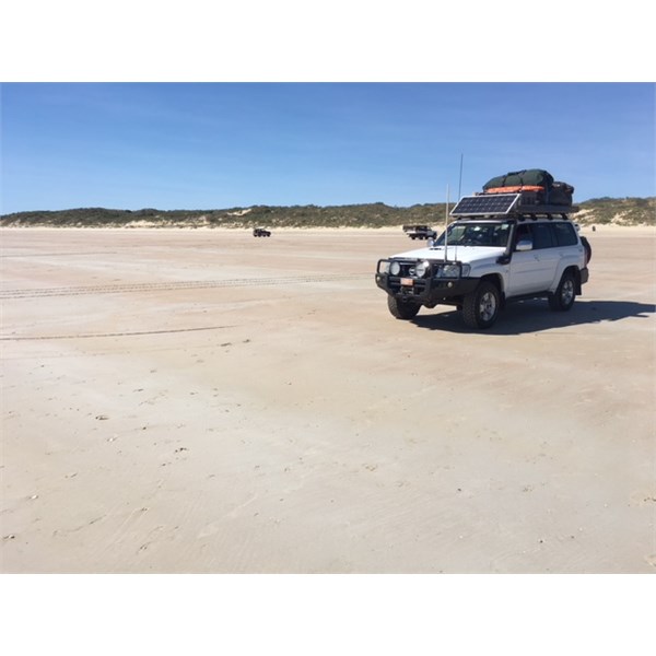

Reply By: Grizzle - Monday, Oct 09, 2017 at 12:27
I have had a 90 Watt Solar Panel mounted on my roof rack for years. Fraser Island, Cape York, Kimberely, Canning Stock Route etc. All driven to from Melbourne so lots of Road and Off-Road kilometres. No issues or stone chips etc. I wash it when I wash the car or when I am in the servo washing my windscreen.
